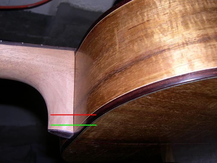

Here's an image of 3 1/2" body at the neck (unfinoshed). I've cut the depth in the body 1/2" from the back plate and I agree that less does not give you much room for error.
The red line represents the depth of the tenon and the green line the depth in the body. So there remains a space here.
